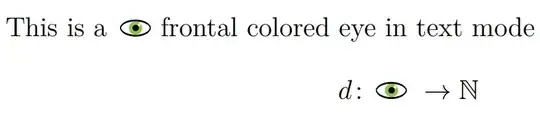

    \documentclass[12pt]{article}
    \usepackage{amsmath,amssymb}
    \usepackage{tikz}
    \usepackage{graphics}
    \newcommand*\frontaleye{%
       \scalebox{0.25}{
\tikzset{every picture/.style={line width=0.75pt}}
\begin{tikzpicture}[x=0.75pt,y=0.75pt,yscale=-1,xscale=1]
\draw  [draw opacity=0][fill={rgb, 255:red, 140; green, 196; blue, 74 }  ,fill opacity=1 ] (104.5,179.99) .. controls (104.5,171.39) and (111.48,164.41) .. (120.08,164.41) .. controls (128.68,164.41) and (135.66,171.39) .. (135.66,179.99) .. controls (135.66,188.6) and (128.68,195.57) .. (120.08,195.57) .. controls (111.48,195.57) and (104.5,188.6) .. (104.5,179.99) -- cycle ;
\draw  [fill={rgb, 255:red, 0; green, 0; blue, 0 }  ,fill opacity=1 ] (84.83,179.7) .. controls (84.92,169.21) and (100.66,160.85) .. (119.99,161.01) .. controls (139.32,161.18) and (154.92,169.81) .. (154.83,180.3) .. controls (152.49,171.04) and (137.8,163.81) .. (119.97,163.66) .. controls (102.13,163.51) and (87.32,170.48) .. (84.83,179.7) -- cycle ;
\draw  [fill={rgb, 255:red, 0; green, 0; blue, 0 }  ,fill opacity=1 ] (113.6,179.91) .. controls (113.6,176.19) and (116.63,173.16) .. (120.36,173.16) .. controls (124.08,173.16) and (127.11,176.19) .. (127.11,179.91) .. controls (127.11,183.64) and (124.08,186.67) .. (120.36,186.67) .. controls (116.63,186.67) and (113.6,183.64) .. (113.6,179.91) -- cycle ;
\draw  [draw opacity=0][fill={rgb, 255:red, 255; green, 255; blue, 255 }  ,fill opacity=1 ] (195,141) .. controls (195,138.24) and (197.24,136) .. (200,136) .. controls (202.76,136) and (205,138.24) .. (205,141) .. controls (205,143.76) and (202.76,146) .. (200,146) .. controls (197.24,146) and (195,143.76) .. (195,141) -- cycle ;
\draw  [fill={rgb, 255:red, 0; green, 0; blue, 0 }  ,fill opacity=1 ] (154.65,179.7) .. controls (154.65,190.58) and (139.02,199.41) .. (119.74,199.41) .. controls (100.46,199.41) and (84.83,190.58) .. (84.83,179.7) .. controls (87.23,189.3) and (101.95,196.67) .. (119.74,196.67) .. controls (137.53,196.67) and (152.25,189.3) .. (154.65,179.7) -- cycle ;
\draw  [draw opacity=0][fill={rgb, 255:red, 255; green, 255; blue, 255 }  ,fill opacity=1 ] (125.45,172.24) .. controls (125.45,170.4) and (126.94,168.91) .. (128.78,168.91) .. controls (130.62,168.91) and (132.11,170.4) .. (132.11,172.24) .. controls (132.11,174.08) and (130.62,175.57) .. (128.78,175.57) .. controls (126.94,175.57) and (125.45,174.08) .. (125.45,172.24) -- cycle ;
\end{tikzpicture}
}\kern-.5em}
\begin{document}
This is a \frontaleye frontal colored eye in text mode and in math-mode
\[d\colon \frontaleye \to \mathbb{N}\]
\end{document}

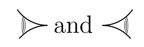

Also pst-optic package have your original \eye as shown in this MWE:
\documentclass[a4paper,12pt]{article}
\usepackage{pst-optic}
\usepackage{graphicx}
\newcommand*\latseye{%
       \scalebox{0.25}{\begin{pspicture}(-1,-1)(1,1)
\rput(1,-.5){\eye}
\end{pspicture}\kern1em}}
\newcommand*\latdeye{%
       \reflectbox{\scalebox{0.25}{\begin{pspicture}(-1,-1)(1,1)
\rput(1,-.5){\eye}
\end{pspicture}\kern.2em}}}
\begin{document} \latseye and \latdeye \end{document}
