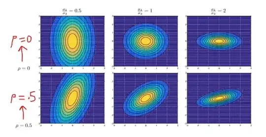

I am using tabular environment to insert subplots. Here is the output
My only issue is that I need entries in left most column to be in middle as indicated by the red arrows. It seems like a straight forward thing but somehow I am not able to fix it.
Secondly, right now individual images take more horizontal space within the table. How do I adjust their size so that they are perfect squares instead of rectangles.
Here is code:

Using the valign key of adjustbox you can get what you want (note that I used another image, as I don't have access to your images):

Skillmon
  • 60,462
  • Could you suggest a way to add caption to each subplot in your solution. I get error "You can't use `\hrule' here except with leaders.\caption@hrule ->\hrule " when I add caption like "\adjustimage{width=.25\textwidth,valign=c}{example-image-duck}\caption{1}" – NAASI Sep 18 '18 at 18:59
  • (Untested) Maybe something like \begin{minipage}{<your width>}\captionof{figure}{<your caption>}\end{minipage} in an extra row (if you get an undefined control sequence \captionof error, load the capt-of package)? – Skillmon Sep 18 '18 at 19:07
similar to Skillmon answer but with little bit shorter code:

Zarko
  • 296,517
Same key: valign=c. Since you load booktabs, I suggest inserting \addlinespace to have a blank space between the rows. Also, I think using the medium-sized fractions from nccmath look nicer:
