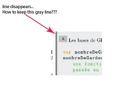

This code is building from the solution posted here.
If this tcolorbox environment is used within a paragraph, the left gray line disappears...
How do you retain the look of the listing with the gray line to the left? Thanks.
Here is the code...

    Rather then frame code try with overlay – Salim Bou Feb 11 '17 at 06:30
    Your problem is not the paragraph, but the page break. If it doesn't break the page the code is fine, but with page break tikz can't calculate the path. – TeXnician Feb 11 '17 at 07:09
    @SalimBou Your version works fine. Please post it as an answer. – TeXnician Feb 11 '17 at 07:10
  • @SalimBou, can you please provide me with some more guidance as to how to implement your solution? Thanks! – Joe Feb 11 '17 at 18:25
    Just replace frame code with overlay and the line appears again. On the second fragment the line also covers part of the continuation title. – Ignasi Feb 11 '17 at 20:12
Just for protocol the answer from the comments. Your problem is not the paragraph, but the page break. This causes the TikZ code in frame code to mess up. Your problem can be solved using overlay instead.
