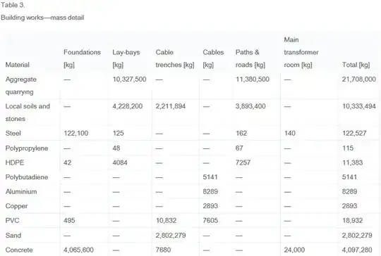

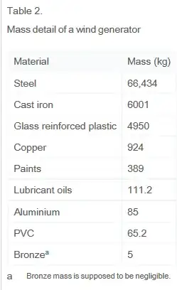

Materials for one wind farm
Here are the two tables identified by THelper, from "Energy performances and life cycle assessment of an Italian wind farm" by Ardente et al (2006):
Materials per 660kW-capacity turbine:
Additional Materials for the whole 11-turbine farm: enter image description here
To get total energy generated, you could assume a 20-year life and something like a 25% capacity factor, to get:
20y x 25% x 11 x 660kW x 8766 h/y
= about 300 GWh of electricity generated over the lifetime, and about 40 kilotonnes of material.
Caveats
660kW turbines are quite small, these days: 2-3MW is more common. So the above windfarm isn't really that representative. Also, the amount of material used for roads and lay-bays could vary a lot, depending on the specific site configuration.
Almost all of that material would be re-usable at the end of life of the farm: the aggregates, soil and stone could be directly reused; the steel would be recycled; and the concrete reused as aggregates. So picking a divisor is tricky - without detailed information on recycling and reuse rates, the number of generations of windfarm served by those 40 kilotonnes of materials is hard to determine, so one might end up picking an abritrary number of generations, changing the end result considerably.
