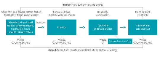

We typically get about 20-30 times as much energy out as energy in. The range in the literature is wide: 4.6-40.
Overview
The ratio of energy generated to energy invested will vary, depending on a lot of issues.
Here, I'll only consider grid-scale wind power, i.e. turbines of 0.5MW rated capacity upwards. That's because they represent the overwhelming majority (by generated power and by economic value) of existing and of potential installation. The Lifecycle assessments in the references include materials, construction, foundations and decommissioning.
source: (4)
For a case where total energy input is higher (such as offshore wind), and total energy output is low (nearshore, downwind from land), you might get 18 times as much energy generated as put in. But as we only have one commercial offshore wind farm in the world that's reached the end of its design life (Vindeby, built 1991-2), it's still generating electricity (beyond its expected 20-year life), and is quite different to more modern wind farms (a lower-capacity onshore turbine installed very close to shore), these are best estimates.
Lenzen (1) looked at the quality of deployment site, as well as variations in transport and country of manufacture, and found a range of 4.6-40 for a relatively small turbine of 500-600 kWpeak
For cases where total energy input is low (easy onshore wind site), and total energy output is high (no obstructions, few turbines downwind from other turbines, high wind speeds), you might get 40 times as much generated as put in. We don't have many years experience of modern 3MW turbines, so it's unclear whether the lifetime is more likely to be 20 years, or 30. Standard calculations assume 20 years.
Larger turbines make for a lower environmental impact per unit energy generated (2).
Sources
In the literature, you find quite a few references to EPBT, rather than EROEI. EPBT is Energy Pay Back Time: the amount of time, from the start of generation, until the input energy is paid back. As a crude rule of thumb, you can divide this into the expected lifetime to get the ratio of energy out to energy in (EROEI aka EROI).
  1. 4.6-40, Capacity factors 18-70% , Lenzen, M. (2004). Wind turbines in Brazil and Germany: an example of geographical variability in life-cycle assessment. Applied Energy, 77(2), 119–130.
  2. Caduff, M., Huijbregts, M. a J., Althaus, H.-J., Koehler, A., & Hellweg, S. (2012). Wind power electricity: the bigger the turbine, the greener the electricity? Environmental Science & Technology, 46(9), 4725–33.
  3. 21-23 850kW & 3MW, 20-year design-life, capacity factor 33-34% Crawford, R. H. (2009). Life cycle energy and greenhouse emissions analysis of wind turbines and the effect of size on energy yield. Renewable and Sustainable Energy Reviews, 13(9), 2653–2660.
  4. 36, 20-year design-life, capacity factor 30%. Vestas (2006). An environmentally friendly investment: Lifecycle Assessment of a V90-3.0 MW onshore wind turbine.
  5. 35-36 20-year design-life, onshore capacity factor 30%, offshore 54%. Vestas (2006) Life cycle assessment of offshore and onshore sited wind power plants based on Vestas V90-3.0 MW turbines. 2nd edition.
