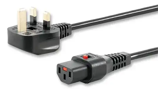

Aside from the permanent solution of superglue there is the option of locking IEC connectors:
The little red "button" you see is a small pull-back lever that releases a friction-lock that holds the ground pin.
This might be enough to deter "simple" people from simply pulling the cord as it's not immediately obvious that it is a lever to release, especially if the lever is facing downwards when plugged in to your PSU. It doesn't stop them from pulling to cord from the wall, though something for that might be a plug cover style device:
At the very least these will prevent anyone "accidentally" knocking the leads out as there is some very definite positive action that has to be undertaken to remove them. If someone goes into the room and the system "just stopped working" then you can say with almost complete certainty that the person had to have done something to make it happen.
