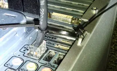

If you are looking for a cheap and easy way to do this, just use zip ties. You can put one near the end of the ethernet cable, one somewhere on the back of the fixed PC (like to an open vent or empty card slot), and use another to connect the two. It wouldn't keep the cables from being unplugged, but it would prevent people from moving the cable more than a few inches from the PC, rendering it useless to use on their laptop.
zip ties holding ethernet cable in place

  • Funny thing is, I don't think I've ever seen this done, its just the first thing that popped into my head. – Kibbee Jan 31 '13 at 15:49
    I'm not sure how well this would work. First couldn't you force the cable through the loop. Second those little zipties are typically only rated for 25/40lbs; snapping one by hand isn't hard; and jamming a pen/cil into the small loop where the one ties onto the case would probably work even if you don't have the strength needed to rip it free. – Dan Is Fiddling By Firelight Jan 31 '13 at 17:10
    You're never going to stop someone who's determined to take the cable. They're more likely to damage the cable than the port trying to remove this, so it should be enough to deter most people. The "connector" tie is probably the weakest point, as the other ones are too difficult to get at w/o a cutting tool of some sort. You could simplify this by just using 1 zip tie and securing the cable to the case directly. – techturtle Jan 31 '13 at 17:31
  • Do a search for stainless steel cable ties and all you have to worry about is people destroying the cables trying to get them free. Make a little sign with a picture of Wolverine saying "ADAMANTIUM CABLE TIES - YOU WILL NOT FREE THEM" and you will be fine. You can also wrap the cable connector sections in tape and make it even more difficult to fool around with. – nvuono Feb 04 '13 at 13:54
  • Instead of using cable ties, just use one of these, loop the cable through and affix it with a self-tapping screw to the metal case. Obviously, make sure there is clearance under the panel so you do not screw it through the CPU… – sleblanc Apr 17 '15 at 23:44

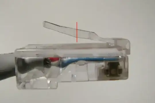

Cable ties are a great idea, but they can be easily cut with scissors or a knife.
An alternative I have used in the past is to trim the release tab back to the point where the cable will still latch into the RJ45 port, but the tab is not accessible to release the cable. This then requires a tool to release the tab because its recessed.
Cut at the red line (approximate). You may have to adjust cut location to suit your needs.

    Clever. I've had cable ends break this way on their own, and I can attest that they are very hard to get out. You would run a higher risk of damaging the port even by someone authorized to remove the cable, though. – techturtle Jan 31 '13 at 17:34
    "Cable ties are a great idea, but they can be easily cut with scissors or a knife. " If you assume users with knives to hand (you should, I have one more or less all the time) then these same users can as easily circumvent this as the cable tie: tip goes in, cable comes out. Perhaps more easily as the motion to release the jack is small and require no appreciable strength. – dmckee --- ex-moderator kitten Jan 31 '13 at 19:36
    Valid points. Not saying the other suggestions are not good. Was just sharing my experience and what I found worked for my situation. There is no correct answer for this question because everything depends on the determination to GET the cable. – CharlieRB Jan 31 '13 at 20:41
  • fwiw: you can hook the cat5 latch out with a pin. – Sirex Jan 31 '13 at 21:00
    I have seen the not-so-techincally-astute simply yank really hard after a point. They assume it doesn't lock in because there's no "unlock" tab to press. – Izkata Feb 01 '13 at 04:27
