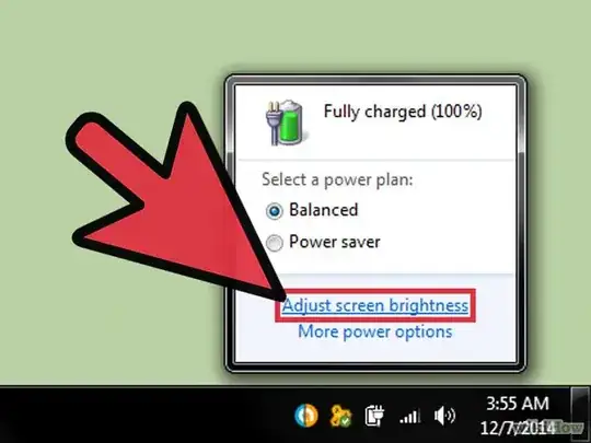

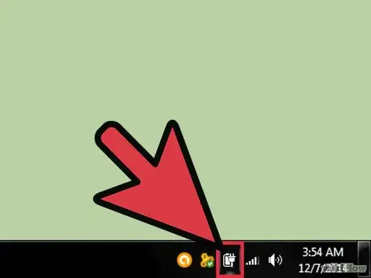

  1. Click the Power Options button in your System Tray. The icon looks like a battery. This will only be present if you are using a laptop. If the Power Options button is not there and you are using a laptop, open the Control Panel from the Start menu and select "Power Options". Desktop computers do not have a brightness slider as brightness is considered a power saving option for laptop batteries.
  1. Click the "Adjust screen brightness" link. This will open the Power Options window.
  1. Adjust the slider at the bottom. This will adjust the brightness of your screen. Low brightness will extend your battery life.

  • Thanks for the answer, but I specifically want a lower brightness than the Windows default lowest brightness - something which I could do in Ubuntu. – Sanchises Jul 07 '15 at 09:40
