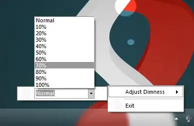

I have extremely sensitive eyes, hence I developed DimScreen. It will appear as a black box in the notification area and you can adjust dimness far beyond the allowed minimum set by your function keys. Its features are the following:
  • Change the brightness by selecting a `% in the tray menu.
  • Or use the hotkeys Ctrl++ and Ctrl+-.
  • Change hotkeys using Settings in the tray menu.
  • Doesn't work properly with video windows.
Could be used for nighttime map reading if your laptop is missing dimming controls.

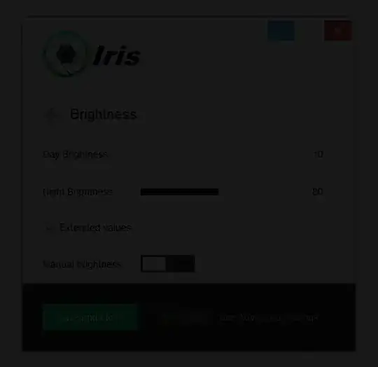

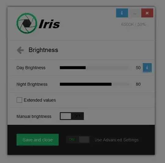

You can get the biggest possible dim range with Iris.
Here is a normal screen with Brightness on 100% enter image description here
If you set Iris to 50% brightness the screen will look like this
You can go as low as 10% if you enable Extended values, but this is really dark screen
Aside from going down you can also go up to 150% brightness. Here is how brightness on 110% looks like
This over the maximum brightness is really useful when watching movies for me
Looking at the other answers most programs lower the brightness by placing a transparent overlay filter.
This method reduces contrast quite a bit and may cause eye problems.
Iris and f.lux should work fine because they change the white point of the screen which is better.
One plus of Iris over f.lux is that you automate the brightness reduction based on day and night just like most blue light filter programs do with the color temperature and blue light.
Iris can do this also but this is not related to the question.
One thing to note is that I don't recommend changing the brightness via monitor buttons if the monitor is LED. Most LED monitors change the brightness via a process called Pulse-width modulation which is really bad for the eyes.
I have some explanation about PWM here: https://iristech.co/pwm-flicker/
