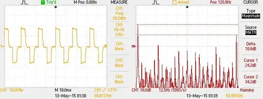

Oscillograms
After fixer1234 added images to his answer, I thought, modified sine couldn't really be that bad, right? I mean, they're going to use more than four steps per cycle, right? Right?
I decided to capture oscillograms of all the UPSes I have here for Science! All of them are made by the same company, but they are from different points in that company's line of products.
For reference, this is what the unfiltered AC line voltage looks like at the test location, with voltage vs time on the left and a spectrum plot of the same waveform on the right:
raw AC from the wall
The big peak at the left edge of the spectrum plot is the 60 Hz fundamental. The large harmonic peaks you see show that my wall power here isn't super-clean. The biggest is the 2nd harmonic at 120 Hz in the middle of the plot, 30 dB down from the fundamental, followed by the 3rd harmonic at 180 Hz off at the right edge of the plot. Then there's that mystery peak at 85 Hz, which I have no explanation for.
This is enough distortion to show up in the oscillogram on the left: notice the somewhat flattened peaks.

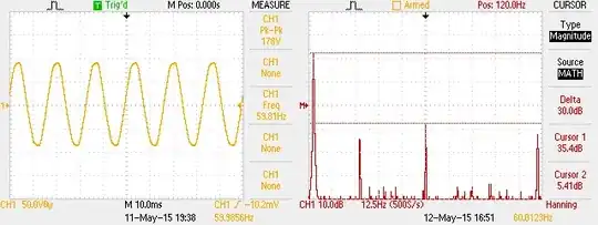

I tested a couple of different true-sine UPSes, which were both fairly expensive. Their output looks like this:
high-end true-sine UPS output
Your eyes are not deceiving you: the on-battery AC output from this particular UPS is cleaner than my wall power! This UPS will run any electronic device within its load limits, because its on-battery output is as close to ideal wall power as makes no practical difference.

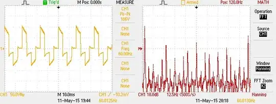

poor-quality mid-range UPS output
This is basically the real-world version of the idealized waveform shown in fixer1234's answer. The answer to my question above, then, is "Yes, they really do make UPSes with output quality that bad."
And yes, it can actually matter in practice. In fact, I chose to test this particular UPS's output for this answer specifically because it has given us trouble in the past.
We had a high-end name-brand PC plugged into this UPS, and on every power blip, the PC — and only the PC — would spontaneously reboot. Everything else connected to the "battery" outlets would stay up. It was so weird that I actually wrote an Arduino program at one point to log "live-ness" over several weeks to try and detect power drop-outs. That little board stayed running the whole time, even when the PC rebooted. We eventually moved that UPS to a big old server, expecting that the heavier load would also cause the same symptom, but no: the UPS has kept that server running through several power blips now.
That UPS's output quality isn't bottom of the barrel. Are you sitting down? Here's a low-end UPS from the same company that made all three of the UPSes above:
low-end UPS output
Ow!
Now you see why this low-end line of UPSes costs about half that of the mid-range UPSes.

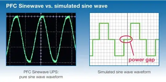

  • Another explanation is described in this announcement from UPS manufacturer CyberPower:
Power Gap
Simulated sine wave output form produces a zero-output state during the phase change cycle resulting in a power "gap". This gap may cause power interruption for equipment with Active PFC power supplies when switching from AC power output to simulated sine wave output (battery mode).
The two explanations are not necessarily mutually exclusive; each could apply in specific circumstances. But for both explanations, there is agreement on three important points:
