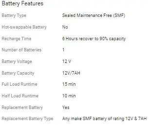

The UPS model is not listed on it's official site(MicroTek) anymore, however it can be found in an Indian E-Commerce site named Flipkart-Here. In case the link goes down, here is the picture of the specs:
UPS Specs UPS Battery Specs
  1. The UPS(say X) has input specs- 230VAC, 50/60 Hz, 4.5A and output specs- 230VAC, 50/60 Hz, 2.9A(Also DC Voltage 12V is mentioned which I do not know why since output is AC). It has one plug that goes into mains for charging itself and 3 output sockets giving AC output.
