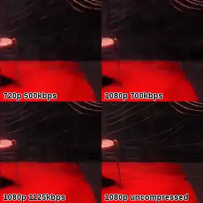

Increasing bitrate and resolution
Here's a comparison of the same region cropped from both frames after scaling to 720p (frame 2097). Look at the fingers, heads and the piece of equipment hanging from the ceiling: even going from 500 to 700 kbps makes a noticeable difference. Note that both images are already scaled to 720p.
Different pictures of frame 2097 side-by-side
Frame 3705. Notice rug's edge and the cable:
Different pictures of frame 3705 side-by-side
Frame 5697. This is an example of frame that doesn't compress very well. 1080p 700 kbps video is less detailed than 720 500 kbps clip (ear's edge). Skin details are lost on all compressed frames.
Different pictures of frame 5697 side-by-side

For 500 kbps, 720p is a bit better than 1080p. 1080p appears sharper, but these details aren't actually present in uncompressed image (left guy's trousers). With 700 kbps I'd call it a draw. Finally, 1080p wins for 1125 kbps: both stills look mostly identical, but picture on the right has more pronounced shadows (pipes on the back wall and in lower right part).
