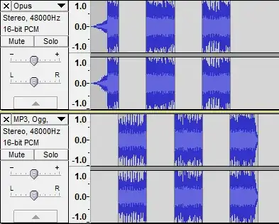

I've made an example audio file which presents this as another exaggerated example. This is the first ~30 seconds of "Tonight" by "The 69 Eyes", alternating every 5 seconds between the following chains:
  • CD → FLAC → Opus
  • CD → FLAC → MP3 → Vorbis → Opus
The effect here is dramatic, with the higher frequencies (i.e: high-hat) being almost completely removed from the audio, and with significant channel (left/right) interaction that is especially noticeable at the beginning.
compare
