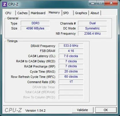

There is software out there that gathers information on some of the main devices of your system.
These program will display the details for you (and more). One example is CPU-Z. A screenshot that shows the information you are looking for:
Now, as per the excellent comment left by Breakthrough (I've copied it in case for any reason he decides to delete his comment):
You can run CPU-Z from a command prompt, and using the -txt=report.txt will place the CPU-Z output into the file report.txt without invoking the GUI (it also mentions a -console switch to output the information to STDOUT, but says it works under Windows XP only for some reason). See additional parameters here for additional details. – Breakthrough
