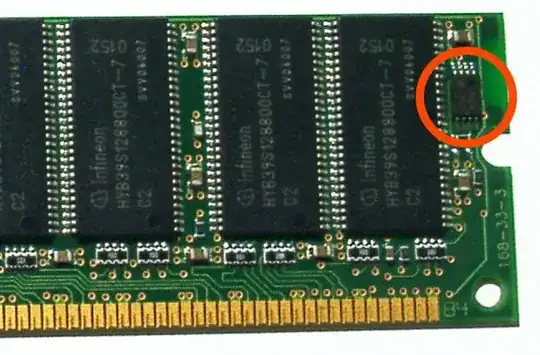

RAM sticks have a small chip on them called the Serial Presence Detect, which contains information such as capacity, preferred timings, manufacturer, and even a serial number.
SPD information is accessible by OSes using the i2c bus (which also includes things like temperature sensors). I think you can directly read the SPDs from Linux using various i2c utilities.
This image from the Wikipedia article has a good picture of it: e
