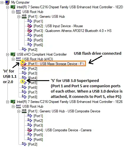

Another way to check whether you are using a USB 3.0 connection or not is to use USBView.exe from Windows Driver Kit (WDK)
You could also use USB Device Tree Viewer, which is very similar to USBView.exe and you won't have to download the huge WDK to use it.
EDITED: in the screenshot below, H is for high-speed (480 Mbit/s) so USB 2.0. F is for full-speed (12 Mbit/s), which can be USB 1.1 or 2.0.
When you run USB Device Tree Viewer, you'll see a list of USB Host Controllers (there are 3 on my notebook). You could cycle through each port of the USB Root Hubs attached to these controllers to see what's connected to that port. You'll find that each USB device connected to your computer (mouse, WiFi or Bluetooth adapter, webcam, etc.) show up on one of those ports.
Detach all flash drives and external hard disks from your computer and look for a USB controller that has no devices attached to any of its ports (on my computer, it is USB xHCI Compliant Host Controller). Now attach a flash drive or external HDD that you wish to test and you'll notice that it is connected to one of the ports of the USB Root Hub attached to that controller.
If you attached a flash drive, it would show up as:
USB Mass Storage Device - [ASSIGNED_DRIVELETTER]
Click on it and look for the Connection Information section on the information pane to the right.
USB Device Tree Viewer - USB Connection Mode
If the device is connected in USB 3.0 SuperSpeed mode, it will show:
Device Bus Speed         : 0x03 (SuperSpeed)
For USB 2.0, it will show:
Device Bus Speed         : 0x02 (High-Speed)
For USB 1.1, it will show:
Device Bus Speed         : 0x01 (Full-Speed)
Besides this, there are also several other methods that are explained in great detail here

    Some additional info: The little 'H' and 'S' in the great tool 'USB Device Tree Viewer' are only visible, if you run Windows 8.x (Text from Uwe Siebers site: "Windows 8 has native support for USB 3.0 SuperSpeed and an enhanced USB stack which delivers more information, e.g. which speed each port supports. Therefore UsbTreeView can show a 'H' in the icon of the high-speed ports and an 'S' for the SuperSpeed ports.") On Windows 7 or older, you will not see this character! – PeterCo Jun 29 '14 at 16:38
  • Very good to know PeterCo, thanks! I was so happy to have found the tool that I missed that note. In fact, Windows 8 displays HS/SS information natively in the control panel, so if all you want to know is bus speed, you don't even need this tool. I noticed that on my Windows 7 system, the H/S badges aren't missing though, but drives will always display 'H' even when obviously running at SuperSpeed. – Daniel Saner May 17 '15 at 10:32

    Worth noting that mine says 0x02 but the entire line is Device Bus Speed : 0x02 (High-Speed) -> not true, see below in Connection Information V2. And in there it shows Usb300 as 1 (true) and has a flag that indicates it is at SuperSpeed. So, the output may look a little different. – AHungerArtist Nov 24 '16 at 17:19
  • @AHungerArtist You're right but I believe Connection information V2 was added in a later version of the app. When I wrote the answer 2 years ago, it didn't exist. – Vinayak Nov 25 '16 at 14:57
