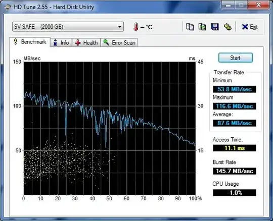

EDIT: Using HD Tune I did a benchmark of my own USB3 drive, which is a caddy providing a RAID1 of two SATA2 5900rpm drives. I'd expect these to operate at about 1.5-1.7 times better than the drive you describe, which is what I got as well. The fact these numbers line up would indicate to me that both our results are in fact capped by the drives in use, not the bandwidth provided by USB3.
HD Tune drive benchmark

  • Maybe I'm reading it wrong, but it looks like your average is well over 3 times mine. Why are you saying your results show only a 150% to 170% increase over mine? I want my new computer and equipment to prove healthy, and for my experience to be "expected", but I don't understand how you interpreted your screenprint. Thanks. – CChriss Mar 16 '11 at 15:31
  • @CChriss You said yours stabilised at 30MB/s. Mine is at 60MB/s and still falling, it hasn't stabilised yet, but did start to get a lot more consistent, so I would expect it to stabilise "soon". These are also read speeds which will be a lot faster (150-170%) than write speeds due to it being a RAID1. It's a bit fuzzy, but I couldn't find a free write benchmark. – Matthew Scharley Mar 16 '11 at 20:58
