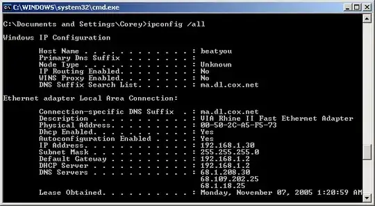

The Windows "ipconfig" command can only show me the parameters from the Ethernet interfaces from my machine (even with the ipconfig /all argument). It can show detailed information about the interface, but it will never show me my external IP address over a NAT network.
ipconfig/all -- Windows screenshot
However, there are several websites, such as "What is my IP address" that can get and show my external IP address. So I'm wondering, whether it is possible to get this value externally? Should I expect that there is some way to get this information from a command line at my local machine...
I need to get this value to log on an application that I'm doing with VBScript. Is there a way to do this, from a cmd on Windows?
