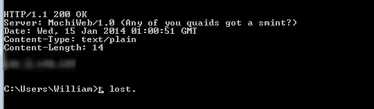

Without third party programs is hard on Windows as Telnet isn't supplied by default, but, if it is there (XP) or turned on (Windows Vista and above), simply type:
telnet curlmyip.com 80
the screen will flash, and you will just get a cursor... Next type:
GET
In capital letters... you will then see the headers, followed by your ip (and sorry I blurred it, just showing where it would be!):
Other answers here obviously work, but, I'm trying to keep to the question on something that can be used on any windows, without third party programs!
