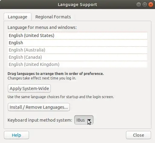

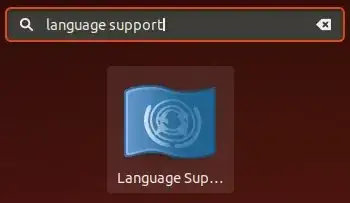

Ubuntu 14.04/18.04 Solution
recently upgrade to 18.04 and fight my way to solve this issue.
  1. open search using super key
  2. go to language support
  3. click Keyboard input method system dropdown menu and choose none
Language Support Menu
  1. dont forget to click - apply system wide
  2. close the window (wont activate until you do)
  3. reboot (logout might be enough)
Credit goes to reverse issue on askubuntu - for some reason someone wants to enable this shortcut.
