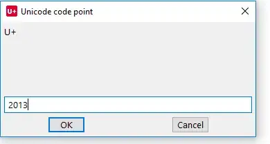

I have written a small AutoHotkey based Unicode Input tool because I did not find a better solution. You can insert unicode characters with Shift+Ctrl+U.
Unicode dialog
Basically, it converts the entry to a unicode character and “types” it at cursor position.
It does not support 6-digit unicode characters. Also, if you have an input field where all text is selected on focus loss, all text will be overwritten (I think I remember an old Firefox version showed this behaviour).
As a reference, here the AutoHotkey source if you want to compile it by yourself:
