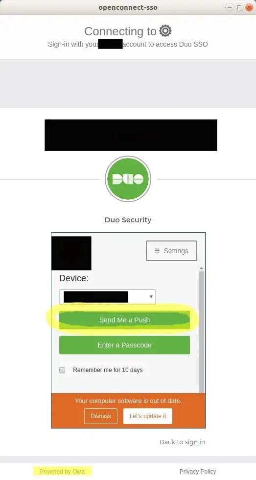

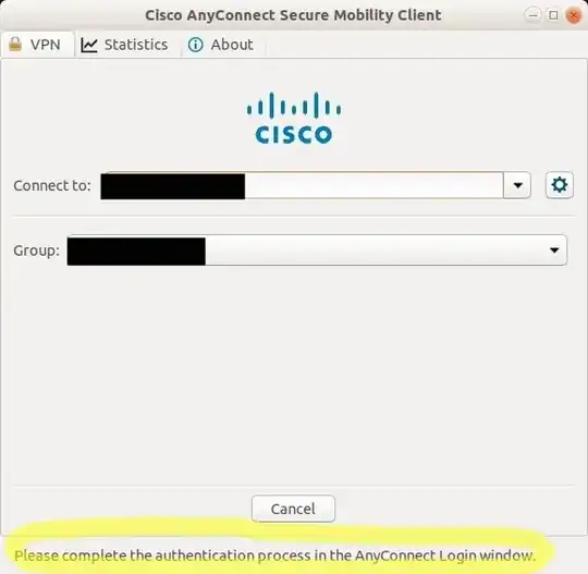

  • I just wrote an alternative solution which details how to use openconnect and openconnect-sso as a total replacement for the Cisco AnyConnect client, here: How to use "openconnect" (via the openconnect-sso wrapper) with SAML and Duo two-factor authentication via Okta Single-Sign-on (SSO). OpenConnect allows local LAN connections while connected to the VPN. Thanks for this great hack to the Cisco AnyConnect client, by the way. I learned a lot from it. – Gabriel Staples Nov 18 '22 at 18:59
14
For those looking to maintain control of their routing table when using a Cisco AnyConnect SSL VPN, check out OpenConnect. It both supports the Cisco AnyConnect SSL VPN and doesn't attempt to disrupt or 'secure' routing table entries. @Vadzim alludes to this in a comment above.
After trying everything but patching the AnyConnect Secure Mobility Client, I was able to successfully replace it on Windows with OpenConnect GUI. This enabled me to maintain connectivity to local resources (and update the routing table).
I use OpenConnect on Windows but it also supports Linux, BSD, and macOS (among other platforms) according to the project page.

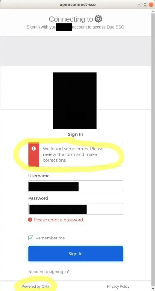

  1. openconnect-sso opens up a web-page which is "Powered by Okta" (as stated at the bottom of it--see screenshot below) and which is requesting my Username and Password for Duo SSO (single sign-on) two-factor authentication. My username and password are already filled in--probably since I've done this before. It says, "We found some errors. Please review the form and make corrections." Ignore that error. I think this is just because the username and password were automatically typed in, and it doesn't detect them yet. To make it detect them, I just have to click in the username box on my already-typed-in username and press Tab twice. That interaction with the input boxes causes the form to detect that my username and password are present. It then automatically validates my username and password since they are already typed in, and then it loads a new web page. enter image description here
  2. On the new page, I make sure my correct phone number or device is selected in the "Device" box, then I click the "Send me a Push" button, and it sends a Duo two-factor authentication push request to my phone. I authenticate on my phone in the Duo app, then the webpage window automatically closes. enter image description here
    Note that in the screenshot above, it says my "computer software is out of date" simply because it wants me to update my version of the Chrome browser to the latest. If I don't do that at least every 10 days or so, the VPN server won't let me log in.

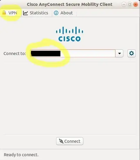

  1. Open the Cisco AnyConnect client and click the "VPN" tab. It will look like this. Your VPN server address is what is shown in the "Connect to" box. enter image description here

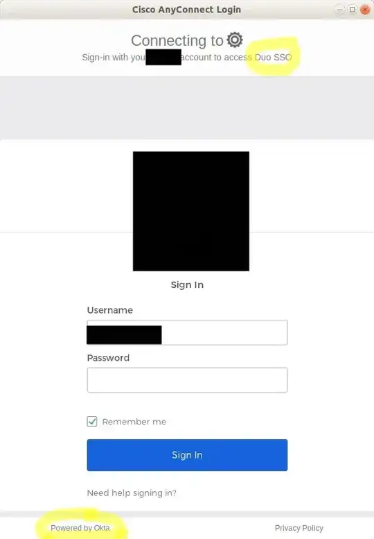

  2. Click the "Connect" button and it will open up a "Powered by Okta" "Duo SSO" window in a new browser window.
    1. That browser window looks like this: enter image description here
    2. The Cisco AnyConnect window now shows a "Group" box which shows your SAML Group: enter image description here
  3. Use that VPN server address and SAML Group name in the openconnect-sso command above.
