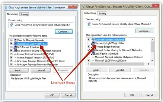

Some softwares conflict with Cisco AnyConnect, as in my case. Had NetBalancer installed and it would stop sending/receiving any packets as soon as I would connect to VPN. another program that I know to conflict is called Connectify.
You can refer to cisco website : Cisco Website
What I did is as below :

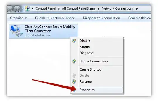

  1. Click on network icon on bottom right Open network and sharing center
  2. Click on change adapter settings on top left
  3. Right Click on Cisco AnyConnect Secure Mobility Client Connection Click on properties enter image description here
  4. Uncheck NetBalancer LightWeight Filter or Connectify Lightweight Filter enter image description here
  5. Click on OK and try connect to VPN now
