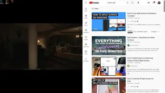

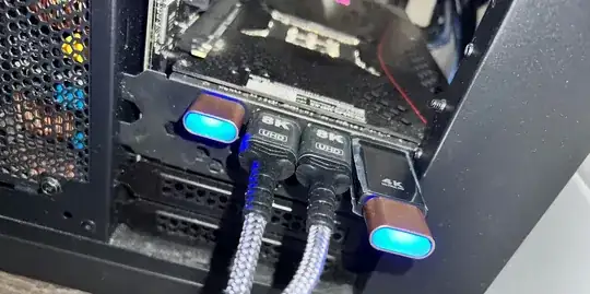

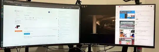

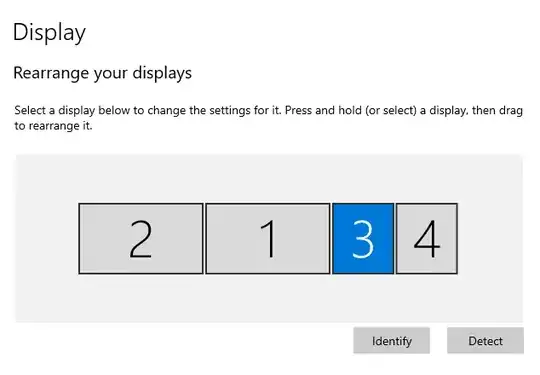

I got it to work as seen below. The second image shows 2 displays working as 3 physical displays. The third image shows the two physical dp cables and the two virtual adapter plugs (https://www.amazon.com/gp/product/B07FB8GJ1Z).
Once the virtual adapters are setup, you can open OBS and get a feed from the two virtual displays to a physical display.
The advantage here is that windows will treat these as 4 physical displays allowing you to run full screen apps on any of them.
To view the feed of the "virtual" displays you need OBS to view the output, and a physical display to actually see anything. I was surprised at how well it works, apps can run in full screen mode or however you want to set them up to run.
This does not use any screen splitting software, it runs natively on your GPU and I was able to run any app in full screen mode on display 3,4.
Another configuration could be 3 adapters ($8 each on Amazon) and 1 physical. With OBS you can display them however you want - 2 on top and 1 on bottom for example.
enter image description here 2 displays acting as 3 enter image description hereenter image description here

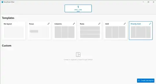

I personally use Microsoft Powertools (link below). This has something called "fancy zones" which are completely customizable. I have a single large 49" LG monitor for work which has a resolution of 5120 × 1440 and I split it up into 3 sections using the standard "Priority Grid" layout so that the main window is focused in the middle of your viewing area. I would recommend anyone to try it out.
https://learn.microsoft.com/windows/powertoys/awake
Microsoft store page: https://aka.ms/getPowertoys
