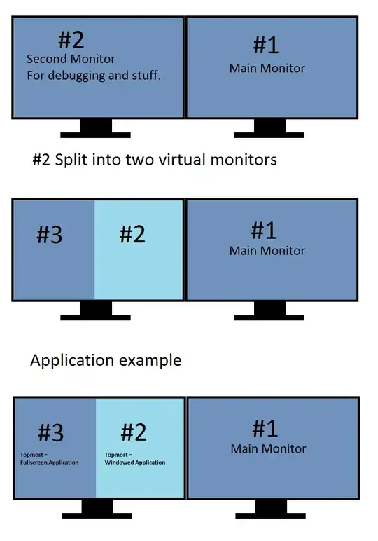

I'm searching for a solution to split one physical monitor into two( or more?) virtual monitors.
Let's say I've a monitor (monitor_a) with the resolution of 1920*1080.
Now I want this monitor_a to be divided into (monitor_a(1)[960*1080]) and (monitor_a(2)[960*1080]).
Both virtual monitors (monitor_a(1) & monitor_a(2)) must be shown at any time. They must be handled just like physical monitors.
If I run an application in full screen on monitor_a(1), monitor_a(2) must not be affected, just as it would be another physical monitor.

I do NOT want to expand the desktop behind the physical limits of the monitor (Virtual Desktop).
Instead I want to divide the physical monitor into two ( or more) virtual monitors.

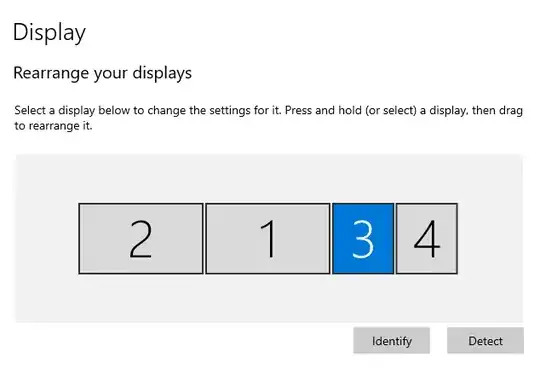

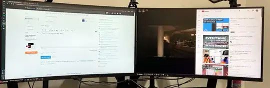

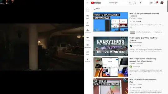

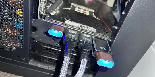

You can split a physical monitor into multiple displays by using dummy hdmi / dp adapters (https://www.amazon.com/gp/product/B07FB8GJ1Z).
Once the virtual adapters are plugged in, you can open OBS and get a feed from the virtual displays to a physical display.
The advantage here is that windows will treat these as 4 physical displays allowing you to run full screen apps on any of them.
To view the feed of the "virtual" displays you need OBS to view the output, and a physical display to actually see anything. I was surprised at how well it works, apps can run in full screen mode or however you want to set them up to run.
This does not use any screen splitting software, it runs natively on your GPU and I was able to run any app in full screen mode on display 3,4.
