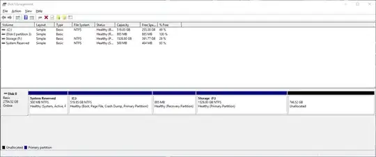

When trying to convert to GPT, I get this error:
PS C:\WINDOWS\system32> mbr2gpt /validate /disk:0 /allowfullos
MBR2GPT: Attempting to validate disk 0
MBR2GPT: Retrieving layout of disk
MBR2GPT: Validating layout, disk sector size is: 512 bytes
Disk layout validation failed for disk 0
Here's diskpart info:
PS C:\WINDOWS\system32> diskpart
Microsoft DiskPart version 10.0.17134.1
Copyright (C) Microsoft Corporation.
On computer: DESKTOP-74HKFD4
DISKPART> list disk
  Disk ###  Status         Size     Free     Dyn  Gpt
  Disk 0    Online         2794 GB      0 B
DISKPART> sel disk 0
Disk 0 is now the selected disk.
DISKPART> list part
  Partition ###  Type              Size     Offset
  Partition 1    Primary            500 MB  1024 KB
  Partition 2    Primary            519 GB   501 MB
  Partition 3    Recovery           885 MB   520 GB
  Partition 4    Primary           1525 GB   521 GB
And here's a picture of disk management:
Disk Management
I've tried shrinking the storage by a few GB in case it was the issue, but no luck. I'm kinda out of ideas. Maybe the recovery partition counts as a primary partition and thus I go over the 3 primary maximum? It shouldn't, but that's the only idea I have left.
    One of mbr2gpt's requirements is that "There are at most 3 primary partitions in the MBR partition table". You have 4, therefore you can't do the conversion with the built-in tool. Use a 3rd party one instead, or delete the recovery partition Cannot convert from MBR to GPT – phuclv Dec 16 '18 at 10:08
  • Well, thanks for the help, I'll try a 3rd party tool for this. As I said in my post, I was confused because all of the info online I found said the limit is 3 primary partitions, and it quite specifically says that the recovery partition made by windows is not a primary partition. – Niko Matikainen Dec 16 '18 at 11:58
    All of the programs mentioned there require a pro version to do this conversion, so I just got rid of my recovery partition. I don't need it anyways since I have installation media available if I ever need to reset to a blank W10. Now it worked, and I finally managed to put that 746GB to use on my storage partition. :) – Niko Matikainen Dec 16 '18 at 12:17
  • just open a real disk partitioning tool to see whether it's primary or logical. I'm quite certain that it's a primary one since Windows never creates a logical partition for its use, and the extended partition is often the last one in the list. However since I don't have an MBR system for a long time I can't verify it – phuclv Dec 16 '18 at 12:34
  • Well, I think it was also mentioned that logical and extended partitions also prevent the conversion, so the result would be the same in any case. – Niko Matikainen Dec 16 '18 at 15:34
