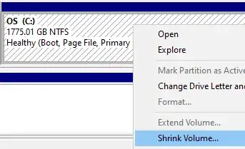

After following through a few red herrings on the internet I had a bit more of a dig into what the tool was up to and it appears that one of the first steps is to shrink the OS partition.
It appears that the fix is actually to preempt this and shrink the OS partition yourself (I reduced it by about 1GB – which made sense as one of the new partitions goes right in at the end of the disk), given these kinds of steps should only be performed by a person who knows what they are doing and understands the implications I won’t go into any detail as to how to do this other than providing the screenshot below.
Disk Management Screenshot
This personally worked for me, and I was finally able to overcome the UEFI boot requirement for Windows 11.
