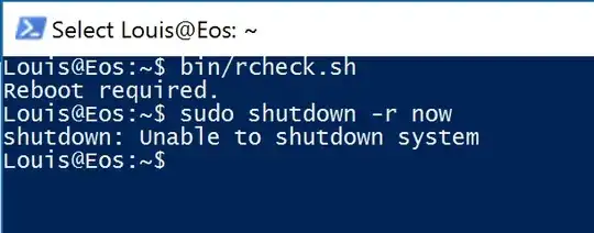

Is it possible to reboot the Ubuntu sub-system without restarting my system?
I tried to use the shutdown command after installing some updates, but that doesn't seem to be an option here.
WSL. Reboot required. Unable to shutdown system
The screenshot text :
~$ bin/rcheck.sh
Reboot required.
~$ sudo shutdown -r now
shutdown: Unable to shutdown system

    Rebooting (standard) WSL is not a thing. Simply put, a WSL distribution is just a container (like Docker) with a shell. Even with WSL 2, rebooting the VM does nothing to a distribution. – Daniel B Jun 02 '22 at 10:46

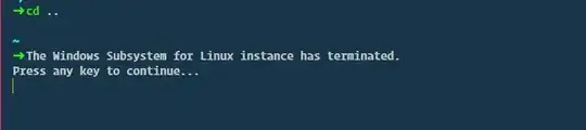

From inside the WSL/Ubuntu terminal, press Ctrl+D to shut down.
Restart ("reboot") the same way you started WSL the last time.
