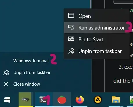

NONE of those answers worked for me but
  1. opening a Windows PowerShell Terminal with Administration rights and then
  2. opening an Ubuntu tab and
  3. executing chmod 666 /path/to/the/file/I/want (feel free to change permissions number)
did the trick
how to open the terminal with admin rights
(1. right-click, 2. right-click, 3. left-click)
good luck with this annoying issue, hope this will fix it
