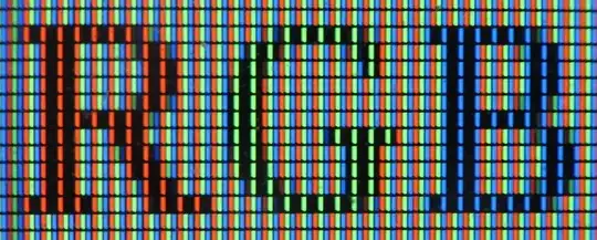

For reference, here's an rgb layout
Each 'trio' of red, green and blue is a pixel, and the pixels are vaguely rectangular here.

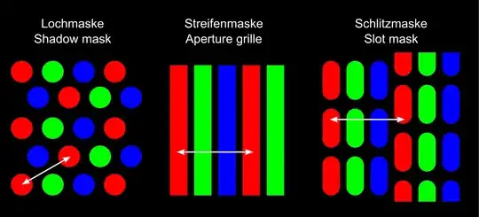

  • I think the shadow mask picture you included is a bit confusing because those are different ways of constructing a CRT screen, and there's no 1:1 correspondence between phosphor dots on a CRT screen and displayed pixels. The distance shown by the white arrow would be described as the dot pitch of the screen, and you would want it to be a bit smaller than the distance between displayed pixels. – nekomatic Jul 25 '16 at 11:51
  • At this point that first RGB layout is more myth than reality. While the positional ordering is still true, it's more like comparing telescopic binary stars (pixels) to spectroscopic binary stars (individual LCD elements) than what that diagram shows on every monitor I have examined with a glass. I got here trying to figure out why cleartype always fails with color fringes no matter what settings I try so it's based in reality not an educated guess. – Joshua Jul 25 '16 at 15:43

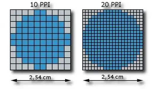

In this case [*] is the inch that has a fixed size of 2,54 cm. The dimension of the pixels can vary.
The PPI is the number of pixel that you can count in one inch of your device.
I think that sometimes a picture is more effective of 100 words. Read more from the source of this figure.
In the picture above the left one has a number of PPI less (10) then the right one (20).
More it is high the number of PPI, more realistic it will appear the image you are looking at.
