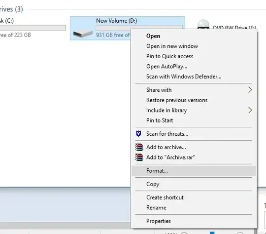

When I plug in my external hard drive (again, NOT USB stick), and right click on the icon in This PC, there is no option to eject the drive.

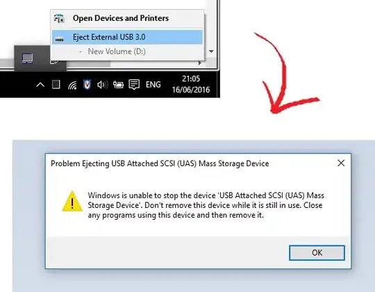

There is a system tray option to "safely eject" it, but that doesn't work at all.
The only way for me to remove it at the moment is to shut down the PC.

  • Check what application is accessing your HDD and close it. If you can't/don't want to close that application search for "Process Hacker" and "Find" all handles to your HDD (search for something like "C:") and close them. – GiantTree Jun 16 '16 at 20:21
  • http://processhacker.sourceforge.net/ " A free, powerful, multi-purpose tool that helps you monitor system resources, debug software and detect malware." It's basically a replacement for the fairly limited Task Manager and works great. – GiantTree Jun 16 '16 at 20:24
  • @GiantTree ok tried that, and sure enough Windows Explorer has a handle to the drive. how to I overcome this? I've already turned off indexing – meowgoesthedog Jun 16 '16 at 20:40
  • Close any Explorer window to it and/or right-click the handle and close it. – GiantTree Jun 16 '16 at 20:42
  • @GiantTree do you know what's causing this? I wunna get to the root of the issue; if you don't then thanks anyway for the link – meowgoesthedog Jun 16 '16 at 20:45
  • I don't really know but sometimes Windows just decides to not close file handles when it should. – GiantTree Jun 16 '16 at 20:46
  • It probably means there is no partially filled buffer to be written and there would be no loss of data with an unannounced disconnection. I just pull the connection out and have never lost anything as a result. – chris Nov 26 '19 at 14:09
  • I see the workaround. Is there a way to put the eject button back in the right click menu and in the File Explorer ribbon menu. – desbest Oct 12 '20 at 17:35

  1. Click Windows icon in task bar.  Click on Run…
  2. Type:
    RunDll32.exe shell32.dll,Control_RunDLL hotplug.dll
  3. Press the Enter key or click on “OK”.
  4. In the “Safely Remove Hardware” dialog click on the device you want to remove, and press Stop.
(from answers.microsoft.com)

    I found a better answer here:
    You should be able to eject these drives by clicking on the “Safely Remove Hardware and Eject Media” icon in the system tray and selecting your USB drive to eject it.
    – nak Jul 30 '18 at 20:43
    You can put the Run command line above in a shortcut on your desktop so that it is easily available. nak's comment doesn't work on Windows 10. – Ron Oct 02 '18 at 20:44
    this is shown in the question to not work. – ths Nov 20 '18 at 20:19
    It solves my problem. I am using Windows 10 and somehow the eject tray icon didn't show up in the tray today. – user3437460 Aug 27 '19 at 02:14
    This doesn't works. I'm getting message that "device is not removable and cannot be ejected or unplugged." Although it's 100% removable hard drive connected by USB. – Oleksii Kuznietsov Apr 20 '23 at 19:42
I found that if you go to Windows/Settings/PC Settings/Devices/Other Devices and click on the name of the device, there is a button to remove device.
Simon W
In the resource manager check to see what's using that hard drive. Control Panel/Administrative Tools/Resource Monitor. Or on command line "perfmon.exe /res". perfmon window Go to the Disk tab and see what Processes have Disk Activity on that drive. This won't solve your problem as windows will probably never put in a nice right click, but it may help figure out what's happening and let you do it without shutting down or sleeping.
Eric
Open up Computer Management, mark the drive offline, it will be then safe to eject.

At this time, Windows 10 does not treat a memory stick on the USB port the same way it treats a Hard Drive. One option is to turn off the computer. That is, go to the Power > Shut Off. An alternative mentioned by someone else is to go to Sleep mode and then wake up. That does not do any good if I just want to remove the USB connected hard drive and continue my other computer stuff. Microsoft has not fixed this problem. Note, it is an interface problem where the operating system (Windows) should manage this. Sorry, people, Microsoft sees no urgent need to correct their operating system bugs. UNIX and Linux do not make these errors because programmers who care about the user have removed many problems Microsoft programs into their operating systems. In review, Shut Down the computer. Then unplug the USB to your External Hard Drive. There are no other solutions.
    Please stick to facts and leave out the opinion. – G-Man Says 'Reinstate Monica' Nov 22 '17 at 02:58
  • Agreed, would be a much better answer without without the commentary. When all other options fail, restarting should work as well, to allow clicking "remove", or shutting down as you mention. I had an Ext. HHD, where the very act of ejecting triggered "System" into writing to log files on the HHD (now in use), for no obvious reason, other than because I had indexed it, thinking it would help me find what I was looking for faster... removing it from the indexing list had no effect, because that requires a restart, (but M$ doesn't tell you that either). Worse yet, the activity light was off too. – tahwos Mar 15 '20 at 11:52
