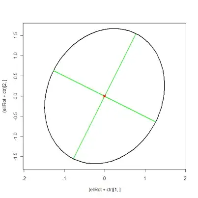

Edit: in order to plot the eigenvectors as well, you have to use the more complicated approach. This is equivalent to suncoolsu's answer, it just uses matrix notation to shorten the code.
eigVal  <- eigen(A)$values
eigVec  <- eigen(A)$vectors
eigScl  <- eigVec %*% diag(sqrt(eigVal))  # scale eigenvectors to length = square-root
xMat    <- rbind(ctr[1] + eigScl[1, ], ctr[1] - eigScl[1, ])
yMat    <- rbind(ctr[2] + eigScl[2, ], ctr[2] - eigScl[2, ])
ellBase <- cbind(sqrt(eigVal[1])*cos(angles), sqrt(eigVal[2])*sin(angles)) # normal ellipse
ellRot  <- eigVec %*% t(ellBase)                                          # rotated ellipse
plot((ellRot+ctr)[1, ], (ellRot+ctr)[2, ], asp=1, type="l", lwd=2)
matlines(xMat, yMat, lty=1, lwd=2, col="green")
points(ctr[1], ctr[2], pch=4, col="red", lwd=3)
caracal
  • 12,009
  • Would you mind to plot the eigenvalues and eigenvectors on this ellipse? Thanks – MYaseen208 Apr 23 '11 at 10:05
  • @MYaseen208 I edited my answer to show the eigenvectors as the ellipse's axes. Half the axes' length equals the square-root of the corresponding eigenvectors. – caracal Apr 23 '11 at 15:05
