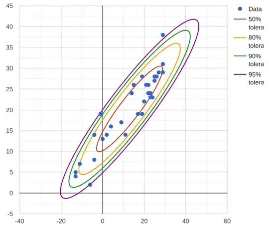

I need to draw a bivariate normal distribution ellipse based on this article. It says
In the case of the bivariate normal distribution, both approximate and exact methods are available for calculations of both confidence and tolerance ellipses. We present our modified version of the exact methods using common statistics of the simple linear correlation analysis. Given n pairs of observations $x$ and $y$, with standard deviations $s_x$, and $s_y$, and correlation coefficient $r$, one must fix the $\alpha$ probability level and take the Snedecor's $F_\alpha$ value with 2 and $n-2$ degrees of freedom. The semi-axes $L_1$ and $L_2$, and the slopes $b_1$ and $b_2 = -1/b_1$, of the axes of the $100(1 — \alpha)\%$ confidence and tolerance ellipses can be calculated using equations (1) and (2), respectively.
$$ L_1, L_2 = K\sqrt{(n-1)({s_x}^2 + {s_y}^2) \pm \sqrt{[(n-1)({s_x}^2 + {s_y}^2)]^2 - 4(n-1)^2(1-r^2){s_x}^2 {s_y}^2}} \tag{Eq. 1} $$
where
$K = F/n(n-1)$ for confidence ellipses
$K = F(n+1)/n(n-2)$ for tolerance ellipses
$$ b, -1/b = ({s_y}^2 - {s_x}^2)/2rs_xs_y \pm \sqrt{1 + [({s_y}^2 - {s_x}^2)/2rs_xs_y]^2} \tag{Eq. 2} $$
I won't have access to all the data points, only the means, standard deviations and $r$. But to test the equations I'm using the following data.

This is drawing an ellipse like
My wrong ellipse
where I should get something like this
The ellipse I should get

Ellipses drawn the right way
It turned out that I lost a lot of time taking the article's formula too serious, it doesn't explain where the formula comes from. So I had to read a lot to understand the context and I'm providing some references for people who's not from maths or stats.
The interesting thing is that I can find $COV(x, y)$ (the covariance of $x$ and $y$) from the Standard Deviations $s_x$, $s_y$ and $r$ (Pearson Correlation Coeficient) as showed here.
Therefore,
$COV(x, y) = COV(y, x) = s_xs_yr_{xy}$
$COV(x, x) = s_xs_x$
$COV(y, y) = s_ys_y$
$C_{xy} = \begin{bmatrix} COV(x, x) & COV(x, y) \\ COV(y, x) & COV(y, y) \end{bmatrix}$ (as showed here)
I calculate the eigen values and eigen vectors based on this refs.
(let [[[eigen-vec-1-x eigen-vec-2-x]
       [eigen-vec-1-y eigen-vec-2-y]] (eigen-vec c-xy)
      [eigen-val-x eigen-val-y]       (eigen-val c-xy)]))
I get the tolerance 50%, 80%, 90% and 95% based on this table (with df=2).
(def tolerances (map chi-squared [0.5 0.8 0.9 0.95]))
The semi-axes and the slope are calculated using
(def x-axis (map #(Math/sqrt (* % eigen-val-x)) tolerances))
(def y-axis (map #(Math/sqrt (* % eigen-val-y)) tolerances))
(def slope  (Math/atan2 eigen-vec-1-x eigen-vec-1-y))
