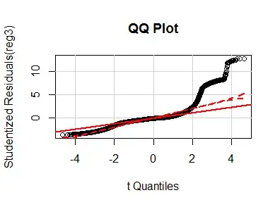

My Error's plot from a linear regression
enter image description here.
Is it Normal distributted? If not, why? What that negative big bar means?
The code used is:

Edited:
A histogram is not the best graph to do this. You are better of using a Q-Q plot, e.g. Regression - How do I know if my residuals are normally distributed?.
If you do that, I suspect you will see that an important deviation from normality/Gaussianity is that the residuals are right-skewed.
