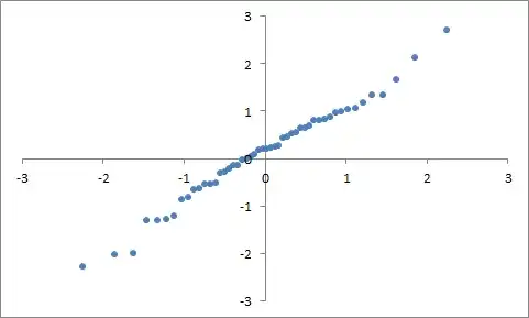

Here's one I just generated in Excel via the above method:
(not the same set of data both times)
You can see the points form a straightish line ... that's because the data was actually normal.
Here's one that's not normal (it's quite right skew):
