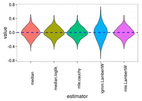

As we knew beforehand, the mean is a bad estimator, so we'll remove it from the plots.
library(ggplot2)
library(reshape2)
theme_set(theme_bw(18))
est.m <- melt(est)
colnames(est.m) <- c("sim.id", "estimator", "value")
# remove 'mean' for good scaling in plots
est.m <- subset(est.m, estimator != 'mean')
ggplot(est.m,
         aes(estimator, value, fill = estimator)) +
  geom_violin() +
  geom_hline(yintercept = 0, size = 1, linetype = "dashed",
             colour = "blue") +
  theme(legend.position = "none",
        axis.text.x = element_text(angle = 90))
They all seem pretty close to each other (with median and IGMM being slightly worse).
