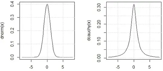

General Abrial and Glen_b had perfect answers. I just want to add a small demo to show you the mean of Cauchy distribution does not exist / does not converge.
In following experiment, you will see, even you get a large sample and calcluate the empirical mean from the sample, the numbers are quite different from experiment to experiment.
set.seed(0)
par(mfrow=c(1,2))
experiments=rep(1e5,100)
mean_list_cauchy=sapply(experiments, function(n) mean(rcauchy(n)))
mean_list_normal=sapply(experiments, function(n) mean(rnorm(n)))
plot(mean_list_cauchy,ylim=c(-10,10))
plot(mean_list_normal,ylim=c(-10,10))
You can observe that we have $100$ experiments, and in each experiment, we sample $1\times 10^5$ points from two distributions, with such a big sample size, the empirical mean across different experiments should be fairly close to true mean. The results shows Cauchy distribution does not have a converging mean, but normal distribution has.

As @mark999 mentioned in the chat, we should argue the two distributions used in the experiment has similar "variance" (the reason I use quote is because Cauchy distribution variance is also undefined.). Here is the justification: their PDF are similar.
Note that, by looking at the PDF of Cauchy distribution, we would guess it is $0$, but from the experiments we can see, it does not exist. That is the point of the demo.
curve(dnorm, -8,8)
curve(dcauchy, -8,8)

    I don't think this shows that the Cauchy distribution has no mean. You could get similar results if you replaced the Cauchy distribution by a normal distribution with a suitably large variance. – mark999 Sep 02 '16 at 11:34
  • good point @mark999, I will edit my answer to address this problem. – Haitao Du Sep 02 '16 at 11:41
  • Is it possible to figure out from PDF of Cauchy distribution that it has no mean, probably by looking at it's fat tails ? – ks1322 Sep 02 '16 at 13:18
  • Perhaps you had something like this in mind? http://stats.stackexchange.com/questions/90531/comparing-estimators-of-location-of-the-cauchy-distribution/90566#90566 – Sycorax Sep 02 '16 at 15:16
