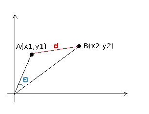

From here:
Let us consider two documents A and B represented by the vectors in the above figure. The cosine treats both vectors as unit vectors by normalizing them, giving you a measure of the angle between the two vectors. It does provide an accurate measure of similarity but with no regard to magnitude. But magnitude is an important factor while considering similarity.

  • This is a general answer. It doesn't explain why in k-means there is no cosine similarity. For instance in hierarchical clustering it is being used widely – curious Jan 07 '14 at 12:06
    @DLDahly: Sometimes magnitude is important, sometimes it is noise. It depends on the research field and is an issue of data standardization. – ttnphns Jan 07 '14 at 13:35
