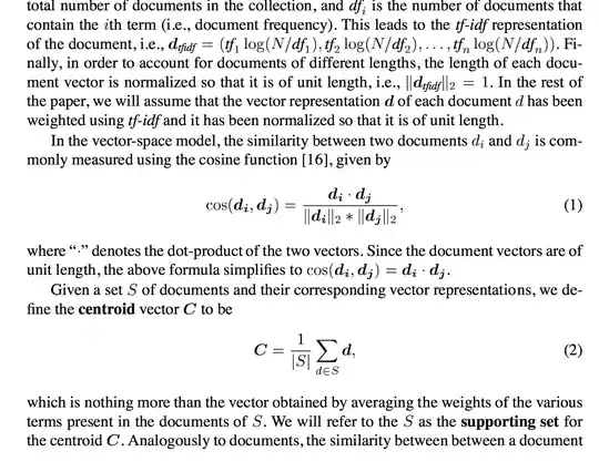

As per http://citeseerx.ist.psu.edu/viewdoc/download?doi=10.1.1.31.7900&rep=rep1&type=pdf it says that you could add up all the vectors and then divide each vector element by the number of vectors.
See image excerpt from the article cited
I personally don't like this formula. The reason is that this does NOT BISECT the angle between 2 Vectors and origin. Example Angle at origin between [1,1] and [1,0] is 45 deg which is SQRT(2). But by the formula quoted in the book, the new vector which will now be the centroid, does not BISECT the angle. So as per formula 1/2 * [1+1, 0+1] which is [1,0.5]. This point does not lie on the bisector.
