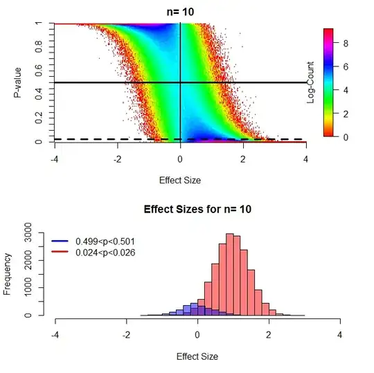

These results are consistent with monte carlo simulations. For this figure I compared two groups with n=10 via t-test at a number of different effect sizes and binned 10,000 p-values into .01 intervals for each effect size. Specifically there was one group with mean=0, sd=1 and a second with a mean that I varied from -4 to 4, also with sd=1.
(The above figures can be directly compared to figures 7/8 from the paper linked above and are very similar, I found the heatmaps more informative than the "clouds" used in that paper and also wished to independently replicate his result.)

R code for figure 1
deltaOnSigma <- 0.01*c(-400:400)
type <- 'two.sample'
alt='one.sided'
p.vals <- seq(0.001,.999,by=.001)
#dev.new() par(mfrow=c(4, 2)) for(n in c(3, 5, 10, 100)){
m<-matrix(nrow=length(deltaOnSigma), ncol=length(p.vals)) cnt <- 1 for(P in p.vals){ m[, cnt] <- LikeFromStudentsTP(n, deltaOnSigma, P, type, alt) cnt <- cnt+1 }
#remove very small values m[which(m/max(m, na.rm=TRUE) < 10^-5)] <- NA
m2 <- log(m)
par(mar=c(4.1, 5.1, 2.1, 2.1)) image.plot(m2, axes=FALSE, breaks=seq(min(m2, na.rm=TRUE), max(m2, na.rm=T), length=1000), col=rainbow(999), xlab="Effect Size", ylab="P-value" ) title(main=paste("n=",n)) axis(side=1, at=seq(0,1,by=.25), labels=seq(-4,4,by=2)) axis(side=2, at=seq(0,1,by=.05), labels=seq(0,1,by=.05)) axis(side=4, at =.5, labels="Log-Likelihood", pos=.95, tick=F) abline(v=0.5, lwd=1) abline(h=.5, lwd=3, lty=1) abline(h=.025, lwd=3, lty=2) par(mar=c(5.1,4.1,4.1,2.1))
plot(deltaOnSigma, m[, which(p.vals==.025)], type="l", lwd=3, lty=2, xlab="Effect Size", ylab="Likelihood", xlim=c(-4, 4), main=paste("Likelihood functions for","n=",n) ) lines(deltaOnSigma,m[,which(p.vals==.5)], lwd=3, lty=1) legend("topleft", legend=c("p=.5","p=.025"), lty=c(1,2),lwd=1, bty="n") }
R code for figure 2
p.vals <- seq(0, 1, by=.01)
n <- 10
n2 <- 10
sd2 <- 1
num.sims <- 10000
sp <- sqrt((9*1^2 +(n2-1)*sd2^2)/(n+n2-2))
p.out=matrix(nrow=num.sims*length(deltaOnSigma) ,ncol=2) m <- matrix(0, nrow=length(deltaOnSigma), ncol=length(p.vals)) pb <- txtProgressBar(min = 0, max = length(deltaOnSigma) , style = 3) cnt <- 1 cnt2 <- 1 for(i in deltaOnSigma ){
for(j in 1:num.sims){
m2 &lt;- i
a &lt;- rnorm(n, 0, 1)
b &lt;- rnorm(n, m2, sd2)
p &lt;- t.test(a, b, alternative=&quot;less&quot;)$p.value
r &lt;- end(which(deltaOnSigma&lt;=m2/sp))[1]
m[r, end(which(p.vals&lt;p))[1]] &lt;-
     m[r, end(which(p.vals&lt;p))[1]] + 1
p.out[cnt,] &lt;- cbind(m2/sp, p)
cnt &lt;- cnt+1
} cnt2 <- cnt2+1 setTxtProgressBar(pb, cnt2) } close(pb)
m[which(m==0)] <- NA
m2 <- log(m)
dev.new() par(mfrow=c(2,1)) par(mar=c(4.1,5.1,2.1,2.1)) image.plot(m2, axes=FALSE, breaks=seq(min(m2, na.rm=TRUE), max(m2, na.rm=TRUE), length=1000), col=rainbow(999), xlab="Effect Size", ylab="P-value" ) title(main=paste("n=",n)) axis(side=1, at=seq(0,1,by=.25), labels=seq(-4,4,by=2)) axis(side=2, at=seq(0,1,by=.05), labels=seq(0,1,by=.05)) axis(side=4, at =.5, labels="Log-Count", pos=.95, tick=F) abline(h=.5, lwd=3, lty=1) abline(h=.025, lwd=3, lty=2) abline(v=.5, lwd=2, lty=1) par(mar=c(5.1,4.1,4.1,2.1))
hist(p.out[which(p.out[,2]>.024 & p.out[,2]<.026),1], xlim=c(-4,4), xlab="Effect Size", col=rgb(1,0,0,.5), main=paste("Effect Sizes for","n=",n) ) hist(p.out[which(p.out[,2]>(.499) & p.out[,2]<.501),1], add=T, xlim=c(-4,4),col=rgb(0,0,1,.5) )
legend("topleft", legend=c("0.499<p<0.501","0.024<p<0.026"), col=c("Blue","Red"), lwd=3, bty="n")
