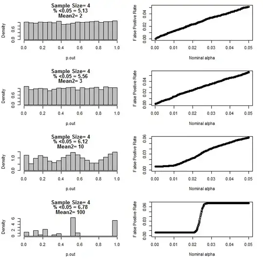

When I examined the n=3 case further, I observed strange behaviour of the p values under these conditions. The left side shows the overall distribution of pvalues calculating using t-tests under conditions of different means for the type2 subgroup. The mean for type1 was 0, and sd=1 for both groups. The right panels show the corresponding false positive rates for nominal "significance cutoffs" from .05 to.0001.
Distribution of p-values for n=3 with two subgroups and different means of the second subgroup when compared via t test (10000 monte carlo runs):
Here are the results for n=4 for both groups:
For n=5 for both groups:
For n=10 for both groups:
As can be seen from the charts above there appears to be an interaction between sample size and difference between subgroups that results in a variety of p-value distributions under the null hypothesis that are not uniform.
So can we conclude that p-values are not reliable for properly randomized and controlled experiments with small sample size?
