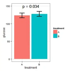

(I) wants a plot that shows the absolute glucose levels in both cases. He fears (R)'s desire for error bars, and asks for standard errors in bar graphs. Let's not start the bar graph war here ._)
bar graphs and SE glucose for two treatments
(I): That cannot be true. The bars overlap, and we have p=0.03? That's not what I have learned in high school.

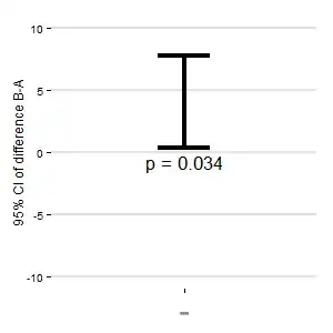

(M): We could also add another plot that shows the relevant confidence interval of the difference. The distance from the zero-line gives an impression of the effect size.
(I): Nobody does it
(R): And it wastes precious trees
(M): (As a good German): Yes, point on the trees is taken. But I nevertheless use this (and never get it published) when we have multiple treatments and multiple contrasts.
