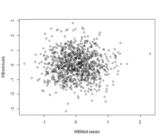

A better chart for seeing if there might be something wrong with the model, beyond a lot of noise, would be to plot residuals against fitted values and see whether there is a obvious pattern which could be addressed with a better model using the existing data. In this case there is no such obvious pattern. (The point I suggested looking at on the previous charts has now moved to the top and looks less special.)
plot(fit$fitted.values, fit$residuals)
