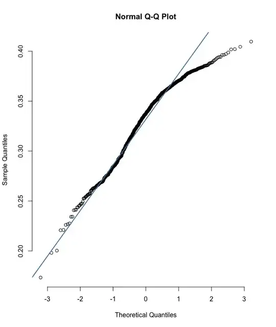

I am trying to create a linear model where the dependent variable has the following summary features:
Min 1st Qu. Median Mean 3rd Qu. Max
0.1579 0.3155 0.3547 0.3459 0.3827 0.4583
There were some notable outliers on both ends, so I used a robust linear regression. In training the model, I logged both the dependent variable and the two main features feeding into the model, and the resulting predictions had the following skew:
After experimenting with a beta regression using the betareg package, the results look much better on the low end of the predictions, but the model still systematically under-predicts on the high end. Any suggestions?

    Welcome to Cross Validated! What's wrong with having skewed predictions? There is no reason to expect the predictions to be normal. Some R code demonstrates that. set.seed(2023); N <- 1000; x <- rbeta(N, 5, 1); e <- rnorm(N, 0, 1); y <- 14*x + e; L <- lm(y ~ x); yhat <- predict(L); qqnorm(yhat); qqline(yhat) The y here seems to have the same kind of skew as yours has. – Dave Nov 01 '23 at 16:53

  • I struggle to understand what your theoretical quantiles are. Are you simulating from a predictive density? Or are you taking quantiles from conditional expectation predictions? If the latter, you may be running afoul of the fact that predictions will almost always vary less than observations. – Stephan Kolassa Nov 01 '23 at 17:00

The QQ plot says nothing about how well the predicted values align with the observed values. Therefore, you are using the wrong tool to assess the fit of your regression model.
What the QQ plot says is how well the values align with a normal distribution that has the empirical mean and variance. In this case, the answer is that your predicted values align rather poorly with such a distribution, but there is no reason to hope they do.
If you want a plot to check how well your observed and predicted values align with each other, plot those, such as I do below.

In this example, the predicted and observed values are quite close to each other.
I suggest doing this kind of plot in your work. The QQ plot answers a totally different question, one that does not seem important to your work.
