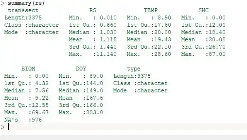

I'm trying to fit a GLM on my dataset which consists of soil respiration data (RS), soil temperature (TEMP), soil water content (SWC), biomass (BIOM), day of the year when the sampling was done (DOY) and the vegetation type (grasslands, old fields, ploughland and oversewn grassland). There are 75 measurements in each transsect.
The values of RS, TEMP and DOY are all above zero, but SWC and BIOM have zero values, and there are NAs in the BIOM variable. None of the variables are normally distributed and there is an order of magnitude difference between the variables.

    Note that there is no assumption that your variables are normally distributed. What makes you think you might need a transformation? – Kuku Nov 23 '22 at 14:05
  • Maybe the fact that there are differences in the range of data (RS values are in the range of 0,1-~3, DOY values are in the range of 89-283) and I do not know how GLM can handle this. – Zita Zimmermann Nov 23 '22 at 14:12
    A GLM (which includes your simple linear regression model) will have no issue including covariates with different ranges. At most, the problem would come for how relevant the interpretation of the coefficients is. Could you write down the model you are interested in and why? – Kuku Nov 23 '22 at 14:21
  • The question is the relationship between soil respiration (RS) and the other variables (SWC, TEMP, BIOM, DOY and type of vegetation) so how the changes of the related variables influence soil respiration (e.g. if the temperature is increasing, will soil respiration also increase?). I am thinking about a model like this: glm(RS~SWC+TEMP+DOY+type) – Zita Zimmermann Nov 23 '22 at 14:29
