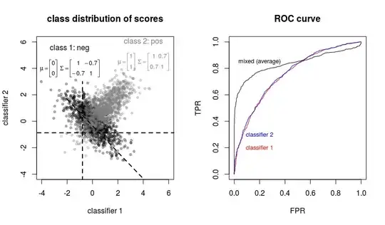

AUC is a simplified performance measure
AUC collapses the ROC curve into a single number. Because of that a comparison of two ROC curves based on AUC might miss out on particular details that are left out in the transformation of the ROC curve into the single number.
So a higher AUC does not mean a uniform better performance.
Example of ROC curves that are better in different parts are in this image, from this question Why did meta-learning (or model stacking) underperform the individual base learners?
You can see on the right that the black curve has a larger AUC, but there is a region where it performs less good.

What if one model has higher AUC and there is no region where it performs worse than the other model? I.e., one model has an ROC curve at all regions better than the other model. Does it then imply that the first model is always better? Or maybe there are other metrics that, depending on our aim and regardless of ROC, can point which model is better? – Glue Sep 07 '22 at 15:56
1@Glue when the ROC curve of one binary classifier is entirely above the ROC curve of another, then it performs better for any circumstance. The only issue that is left that is the point made in the answer by Bernhard, which is that you might deal with empirical ROC curves and the true curves could be different. – Sextus Empiricus Sep 07 '22 at 16:11
2@Glue as pointed out by Sycorax, there are things that aren't measured by ROC curves, like calibration, but also runtime, memory requirements, storage... – Davidmh Sep 08 '22 at 12:48
1Ah, as Davidmh says, there are indeed other types of performance (although that sounds more as costs and requirements of the classifier than performance/output). – Sextus Empiricus Sep 08 '22 at 15:43
