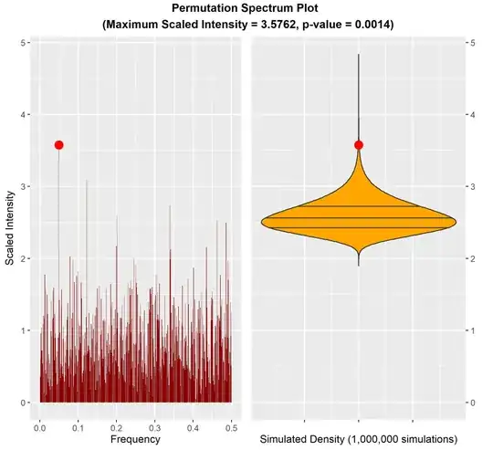

We can see that there are some spikes at particular frequencies in the Fourier domain, but are they big enough to falsify the assumption that this is exchangeable noise? To test this we implement the permutation-spectrum test and produce an appropriate plot. In the present case the test correctly identifies strong evidence that there is at least one signal in the data. (The p-value for the test is $p=0.001385$.)
#Implement the permutation-spectrum test
TEST <- spectrum.test(X)
plot(TEST)
TEST
    Permutation-Spectrum Test
data: real time-series vector X with 1000 values maximum scaled intensity = 3.5762, p-value = 0.001385 alternative hypothesis: distribution of time-series vector is not exchangeable (at least one periodic signal is present)
