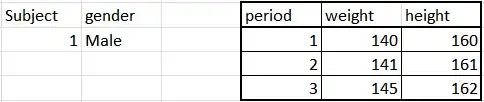

The third common dataset type is a panel, particularly, the one iwth longitudinal data. Here, you may get several snapshots of weight and height variables for a number of students. This dataset may look like waves of cross-sections or a set of time series.
Naturally, this can be more complicated than previous two types. Here we use panel regression and other special techniques developed for panels.
Summarizing, the reason why time series regression is considered as a distinct tool compared to cross-sectional regression is that time series present unique challenges when it comes to independence assumptions of regression technique. Particularly, due to the fact that unlike in cross-sectional analysis, the order of observations matters, it usually leads to all kinds of correlation and dependence structures, which may sometimes invalidate application of regression techniques. You have to deal with dependence, and that's exactly what time series analysis is good at.
