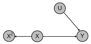

Also, for $Z$ to be usable as instrumental variable, certain conditions have to be satisfied. In particular: $$ (Z \perp\kern-5pt\perp Y)_{G_{\bar X}}, $$ meaning that in the graph $G_{\bar X}$, which is the original graph $G$ with all the arrows going into $X$ being cut off, there must not be any d-separation open path between $Z$ and $Y$. But the original graph $G$ looks like this:
and $G_{\bar X}$ then is:
and the path $X^2 \leftarrow X \to Y$ is clearly an open path. Thus, this condition for $X^2$ being an instrumental variable is violated.

  • About regressing $X$ on $X^2$, when you write "This in turn would result in the method of instrumental variables not working well.": formally, which property would it be violated? – Star Jul 31 '22 at 10:07
  • Even if all the requirements for the method of instrumental variables are satisfied, of course, the quality of the result still depends on the quality of the regression $Z\to X$. – frank Jul 31 '22 at 10:28
  • How do you enstablish the quality of the regression Z on X? – Star Jul 31 '22 at 10:31
  • You have to find a regression of $X$ on $Z$ (i.e. $Z\to X$), not $Z$ on $X$. – frank Jul 31 '22 at 10:34
  • Yes sorry. How do you enstablish the quality of that? – Star Jul 31 '22 at 10:45
  • There are many metrics, e.g. the coefficient of determination. But the main point here is that you later want to regress $Y$ on $\hat X(Z)$, and if $\hat X(Z)$ is a really bad regression, i.e. your input is already wrong, you cannot expect the result to be useful. Now, imagine your values for $X$ are in the interval [-10, 10]. If you decide to regress $X$ on $X^2$ ($X^2\to X$), you have to make decisions about the sign, e.g. you have to decide whether you assign to $X^2=100$ the value $10$ or $-10$. – frank Jul 31 '22 at 11:02
  • And whichever you choose, then, either for $X=-10$ or for $X=10$, you will be off by $20$. – frank Jul 31 '22 at 11:02
  • I'm sorry, but you keep using words like "bad" regression, "wrong" input, which I do not understand in practice. If I regress $X$ on $X^2$ what goes wrong in Stata (or R)? – Star Jul 31 '22 at 11:08
  • Also, in your path representation, why does the arrow goes from $X$ to $X^2$? Couldn't it go from $X^2$ to $X$ just by thinking about the inverse function? Is this just a feature of the quadratic function? What if $f(X)$ is a one-to-one mapping? – Star Jul 31 '22 at 11:23
