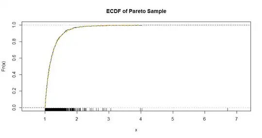

Sample from a Pareto distribution. If $Y\sim\mathsf{Exp}(\mathrm{rate}=\lambda),$ then $X = x_m\exp(Y)$ has a Pareto distribution with density function $f_X(x) = \frac{\lambda x_m^\lambda}{x^{\lambda+1}}$ and CDF $F_X(x) = 1-\left(\frac{x_m}{x}\right)^\lambda,$ for $x\ge x_m > 0.$ The minimum value $x_m > 0$ is necessary for the integral of the density to exist.
Consider the random sample y of $n = 1000$ observations from $\mathsf{Exp}(\mathrm{rate}=\lambda=5)$ along with the Pareto sample y resulting from the transformation above.

Below is the empirical CDF (ECDF) of Pareto sample x along with the CDF (dotted orange) of the distribution from which it was sampled. Tick marks along the horizontal axis show individual values of x.
    plot(ecdf(x), main="ECDF of Pareto Sample")
     curve(1 - (x.m/x)^lam, add=T, 1, 4,
           lwd=3, col="orange", lty="dotted")
     rug(x)

  • So briefly, does that mean or does that not mean the exponent of an exponentially distributed random variable is Pareto distributed? – Richard Hardy Nov 30 '21 at 12:49
    @RichardHardy I suspect it is trying to say yes, with minimum value $1$ (and shape parameter $\alpha=\lambda$) – Henry Nov 30 '21 at 13:52
